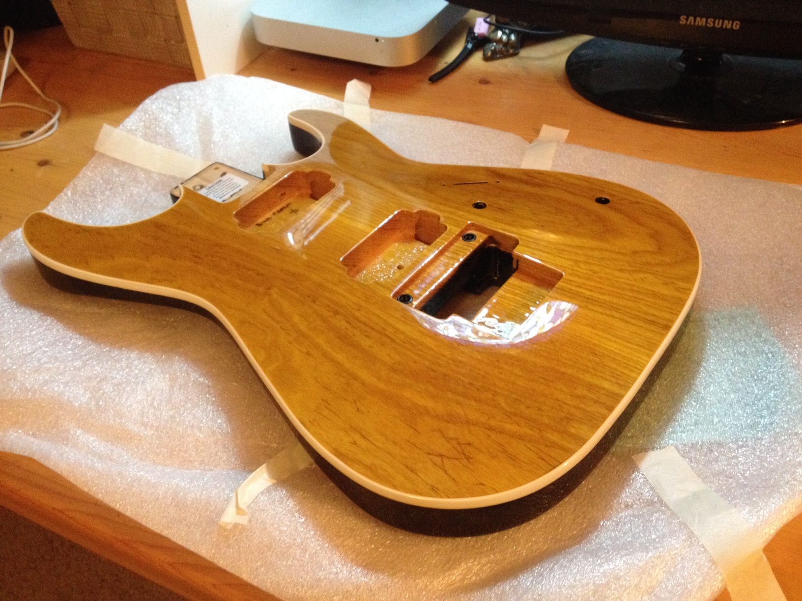

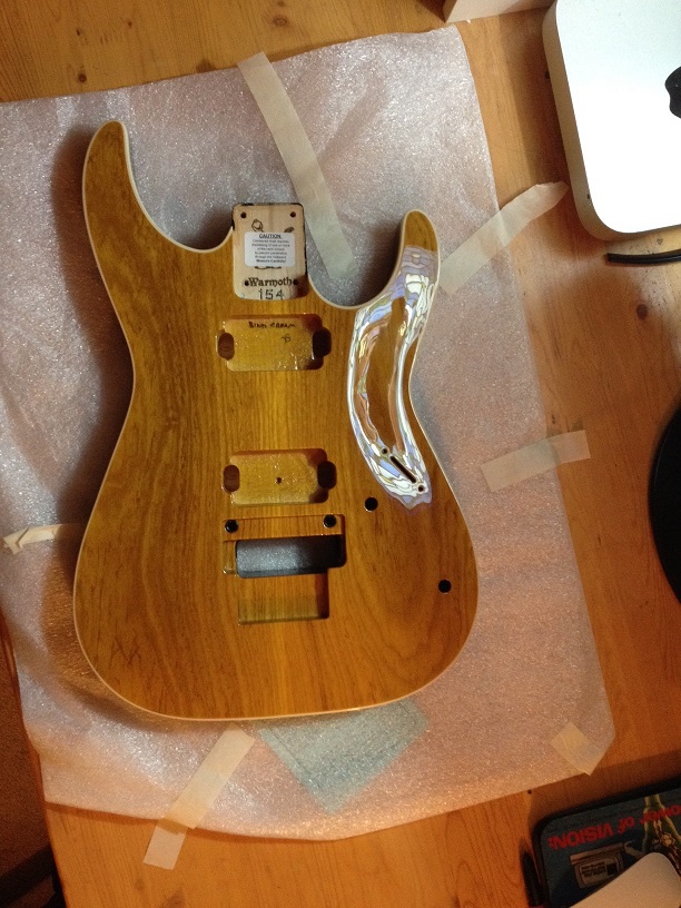

Here's some impressions of mine: I prefer the more dramatic curves of the old carved top of ten years ago, but this is still a sexy looking top.
It's quite light before anything is mounted to it.
I initially wanted to not have any binding (ten years ago, binding wasn't even an option for the soloist carved top!) but now it's mandatory, so I went with creme. Which I'm pleased about now, because it looks very nice with the vintage tint top... kind of complimentary.
For some reason I thought they would include a cover for the trem cavity? Fack, now I have to order one!
Well the neck and some more hardware are going to come a bit later.

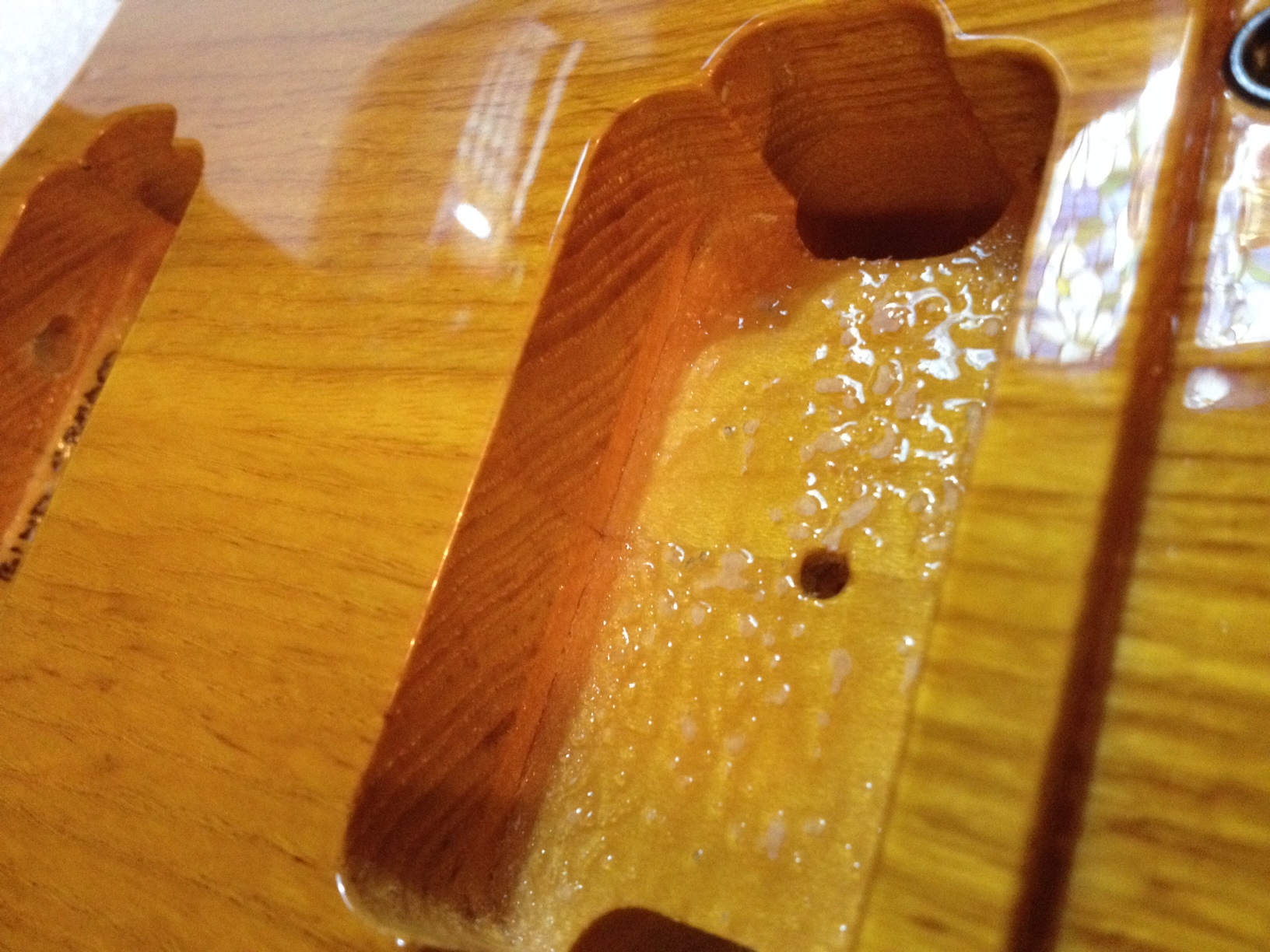

Included pic of the binding leading into the black back, as well as a closeup of the seam between ash and basswood. I'm liking the thickness of the top, it seems to me to be enough to enhance the tone.

Hey sorry if the pics are too big. I can't replace them.
I'm attaching them again at a more reasonable size.

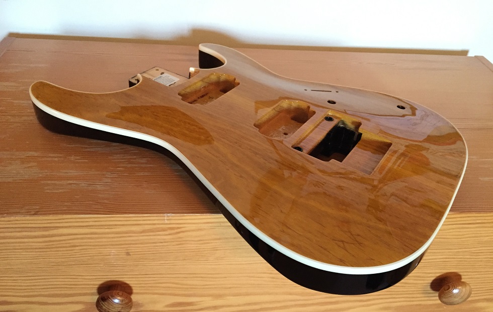

Here's a pic my girlfriend took. She's a much better photographer.
