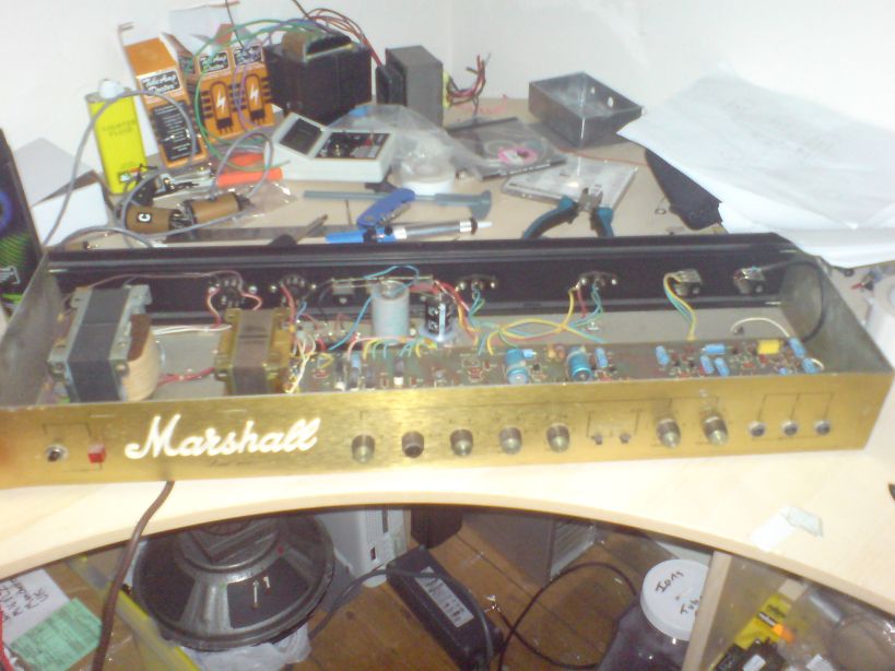

Marshall lead 100 2098. Marshalls 1st attempt at an SS head and by all accounts they got it very wrong. It looks like the preamp is fucked somewhere as it plays fine plugging into the loop (TRS to send and return on the same socket :facepalm:). I'm gonna poke about to see if I can get the bastard working again. If not then it'll do as a slave unit I guess. Its worth pretty much fuck all although the noise kids go nuts for them.

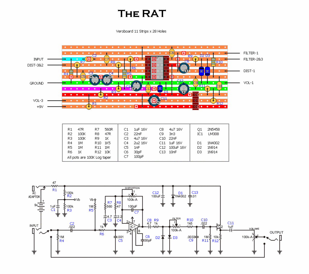

layout i'm using. My friend who I built it with has used this one before.
also I have a dpdt (on-off-on) switch to switch between diode and LED clipping with the off position for clean(ish) boost.
Fri Jul 16, 2010 11:26 am
Post Re: The workbench thread
The TL071 is a usable sub, and i have one of those in my latest rat build as well.
It works fine. BUT you have to be sure to leave out the 30pf cap that is supposed to sit between pins 1 and 8 (C6 on that Torchy layout), as that cap's purpose is not needed or utilized by the TL071 type IC.
I would also suggest double checking your subbed values, as it is also possible that you don't have what you think you have in some spot. I have done that before, swapping an orange band for a red one or something on a resistor in a piggyback and winding up with a total value much different than what i meant to achieve. If you do not already, it is a good idea to test the piggybacked values with a multimeter before you solder them in, to ensure that you haven't done anything silly with your eyes, or the math.
I would say that if you are passing sound(even if it has a pile of oscillation right now) it is probably an easy fix to get going right. :idk:
I assume you have looked over the thing with a magnifier or something to determine beyond the shadow of a doubt that you don't have any hairs of solder bridging the traces in any place?

Ah didnt know about the 30p cap. I'll try taking it out. I'll double check the board but I'm pretty sure there arent any shorts. I rescore in between the traces with a knife anyway. Pretty certain we checked all the parts with a meter first but I'll have a look over it again to be sure.
cheers man!
